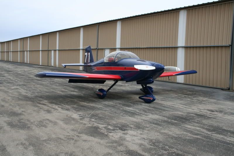

This morning I went to the airport, installed the battery and tested the new semi-flat tips. The resulting speed was 181.5 kts. After the flight it took me 2 hours to replace the semi-flat tips with my 3" span streamlined tips and refruel.
I reflew the test and the resulting speed was 182.3 kts so I do not intend to pursue the flat tips any further.

I saw and felt no vibration or other adverse effect from the flat tips. I cut down the spanwise gap between the aileron and the tip from 5/16" to ~ 1/8". The take off roll seemed longer with the flat tips and the plane required what seemed like a lot more right rudder to center the ball - like almost standing on it in the climbout and quite a bit in level flight. It was not at all difficult to fly just the ball wanted to rest off to the right more than usual. On the first leg I was feeling pretty good looking at 206.4 kts ground speed tracking 360. Even after I turned to 120 the ground speed was 175.4 kts (5 consecutive 20 sec. interval average). Then when I turned to 240 it dropped to 159.8 kts so I knew it was not going to be a big breakthrough modification. Later at home when I plugged the numbers into the NTPS spreadsheet the result was 181.5. There was some minor evidence that the rear edge of the right tip contacted the aileron (1/16" paint chip on the aileron and some epoxy resin missing from the tip). When I took off the ATIS gave the surface winds as calm but when I returned after the test flight they were 170 at 7. The calculated wind speed at 6,000 ft density altitude was 201.1 at 26.9.
After I went through the change to my streamlined 3" tips the surface wind on ATIS was 170 at 10. When I returned it was 170 at 10 gusting to 18. The calculated wind at 6,000 ft d alt. was 197.6 at 36.9. The leg speeds with the same 360, 120, 240 GPS ground tracks were 217.2, 170.8 and 153.4 respectively.
It is obvious that the wind was building and the most significant change may have occurred during the first test flight. There can certainly be a case made for retesting but my gut, the inflight feel and the NTPS numbers tell me not to waste any more time on this (I can sense John Huft cringing). Time and money resources have to be respected when you believe the mod is a lost cause. I have no doubt that it is faster than the stock tip but what I developed before is better I think.
If you would like to do the short tip and aileron plug mod that may not be as much trouble as you think. I made balsawood plugs for mine in an earlier unsuccessful test that worked very well. I installed the plug into the recess, drilled a pilot hole through it and the end aileron rib, installed it with some automotive silicon sealant, a dimple washer and a flathead sheetmetal screw. It was solid and I was able to dig it out without too much trouble after the test showed a speed loss instead of a gain. I think the speed loss was due to the opening on the high pressure lower side of the wing being left open while the exit low pressure side was being blocked off. I've got an idea for a closure fairing around the aileron mount after which the plug and another upper surface closure mod may go back in. Just thinking at this point.
