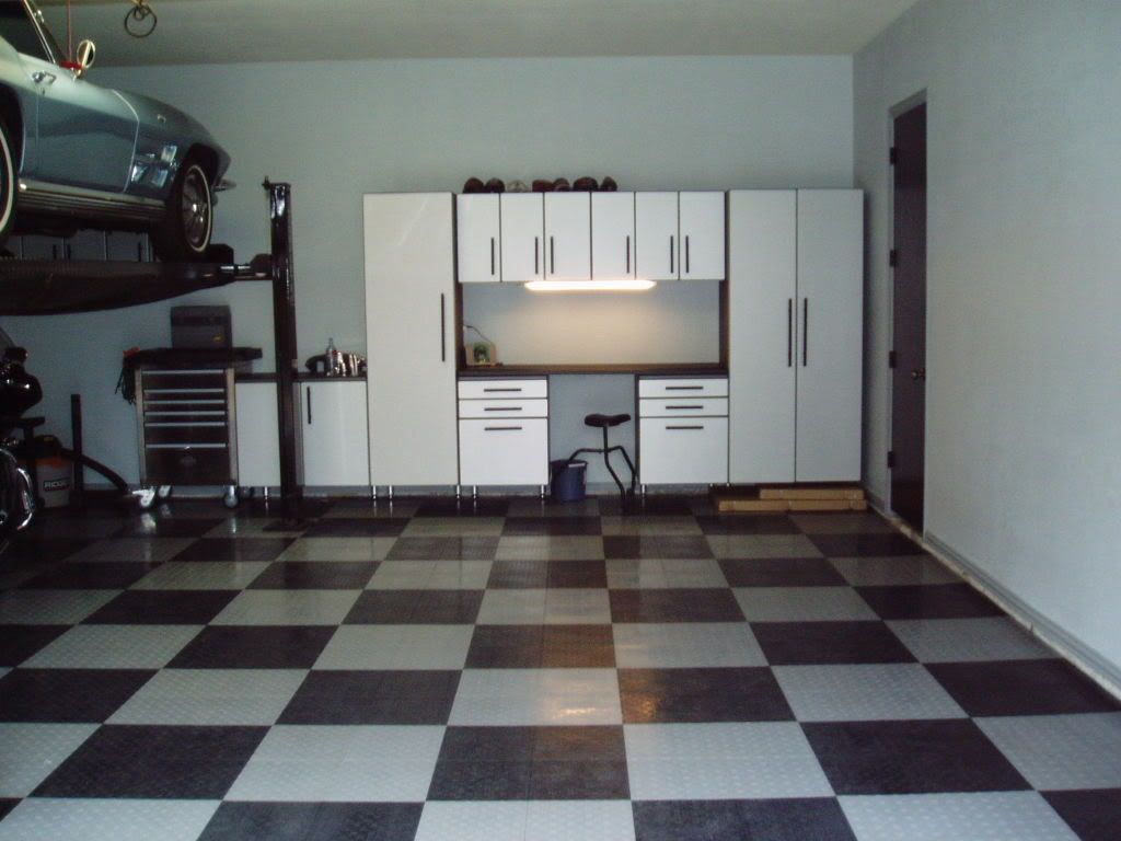

I used Swisstrack tile on my hangar floor at about $4 per tile.
I get tons of complements on the looks and I put it in myself over a couple weekends even with stuff in the hangar like Doug hopes to do.
It does have some properties I don't care for.
I get lots of static shocks touching the plane, wall switches or anything else metal. Haven't found a way to ground it.
Walking on it is kind of noisy too. It makes a sound similar to wearing metal golf shoes on concrete?
My fuel vents leaked over a weekend and melted about a dozen tiles, I know they say that can't happen but it did in a hot hangar with the leaked fuel.
It went down easy, looks great but it isn't perfect and costs about the same as epoxy coating.
The main reason I didn't go epoxy was I rent this hangar, why improve someone elses property? I can remove the tiles when my lease is up, can't do that with epoxy.
For my home garage, I will do epoxy when I build the garage this year.

I used the foam locking 2' squares from Sears...Costco colors were um let's say a little to "bright" for me. I really think they worked well to preserve feet and back during long hours of standing and now they live in the hangar since the build is done. Worth the 50 bucks or so they cost. And if Old man Leffler endorses them you know they're good!!

I've used both the RaceDeck brand product as well as the cheaper MotoFloor brand that RD manufactures for Cosco. The MotoFloor brand is normally priced at Cosco around $2.50 per square foot and they often run sales that brings the cost down below $2 / ft. (ironically the product is on sale at Cosco today).
I haven't experienced the static shocks that jimpappas mentioned, but this type of flooring can be a bit noisy to walk on as he described. I have spilled my share of fuel and oil on the flooring without a problem and it does clean up easily with products like 409, Simple Green, etc. One issue regarding spilled fluids to consider is that when liquid passes between the tiles, it is going to be trapped underneath the flooring unless you remove a section and clean it.
I think overall it is a nice alternative to epoxy. Like anything, there are some pros and cons.

Doug ,
You are welcome to come by and look at my install.
I did my garage about a year ago, the floor has held up well and I have a car lift in the garage.
2 cons:
Its noisy to walk on.
If you turn your tires while not moving it will pull up the tiles.
Tim Blake

You got it, that is a major risk and I take great care to touch another surface before and while touching anything near fuel caps.
I get the static in winter with floor heat as well as summer and humidity.
Not sure what is causing it, might be the shoes but I need to find a solution before it becomes a problem.
They are great for appearance, clean up, the ones that got ruined were easy to pop out and replace, you can change the design, lots of pros.
Only those couple negatives to work out.

The wind doesn't affect them, but the sun causes them to expand.
