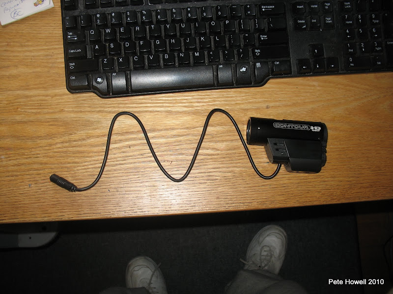

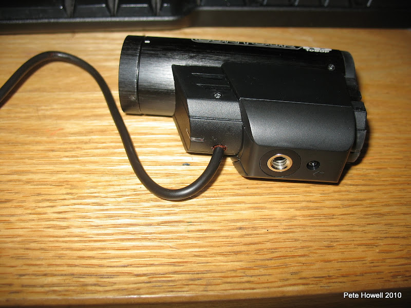

Old 02-06-2010, 08:40 PM
petehowell's Avatar
Location: MN
Posts: 2,269
Default Modded Contour HD 1080p
Did some surgery on Peter F's 1080p last night to enable external audio. No clue why he trusted me. Maybe the late nights with the new baby have made him "logic challeneged"
Took about an hour and turned out pretty nice!
Video after the latest Snopocalypse clears out of the upper midwest!
