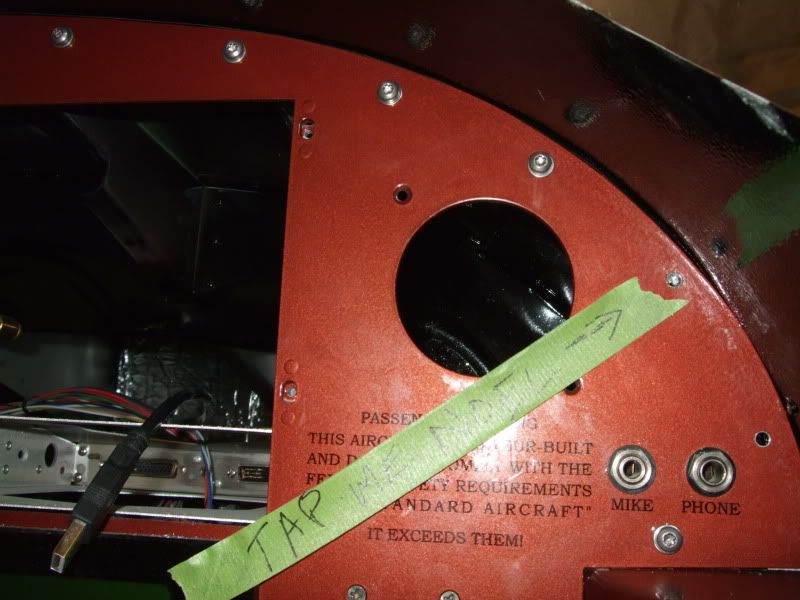

We put ours here...
after looking at a lot of others and comments about how they liked various locations...
Dave & Trina

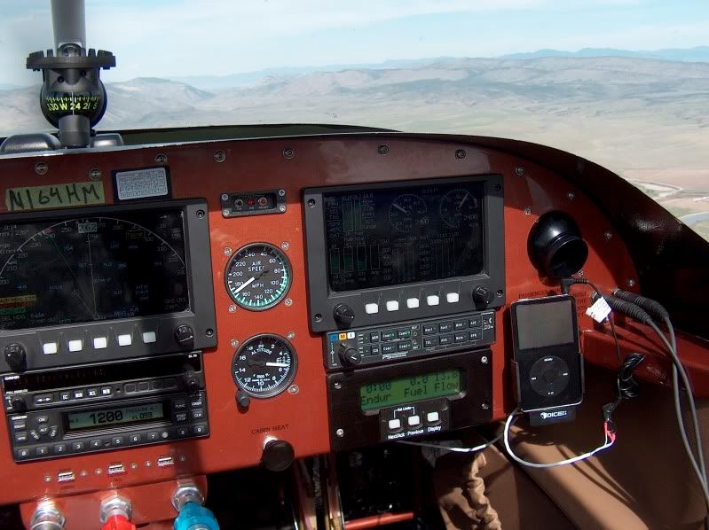

I noticed how many of these examples would not work with an interior, here is what we did:
In action, you can see the headset wires to the right of the ipod:
A close up on the passenger side:
The two vertically oriented holes on the left are where I installed the pilot's connection.
