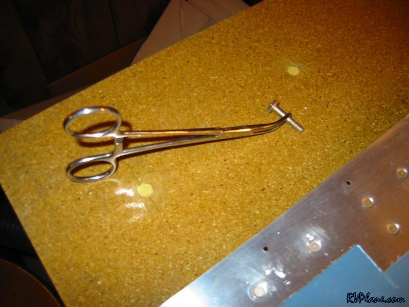

I was struggling with this a couple of days ago also. I tried pliers, magnets, you name it. Then I remembered that I had a pair of 6" curved forcepts. They worked perfectly. Radio Shack has them for $6.99, Model: 64-2961.
Here they are in action:
http://www.rvplane.com/showthumb.php...e=IMG_5972.JPG
