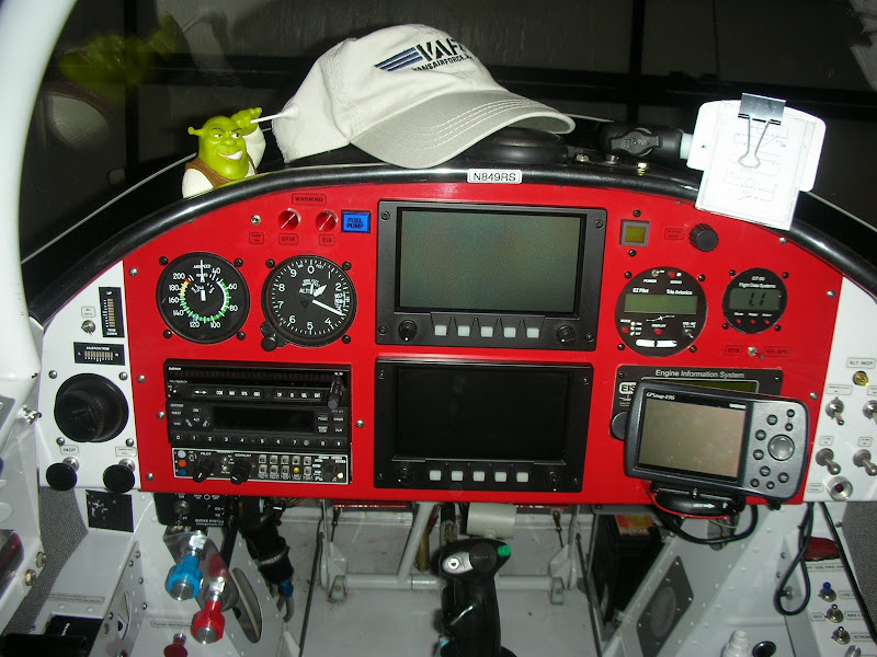

Is to use a RAM mount. If you have room at the bottom of your panel (or elsewhere) for a 1 inch ball mount, you can then get various RAM mounting arms to position the GPS where you want it. In this picture you can barely see the ball mount attached to the panel just under the main knob on the transponder.
Good luck!

I like having the GPS in front of the panel, rather than imbeded in a Gizmo mount. That way you can grip the GPS with your fingers while you hit the buttons with your thumb. Positon it so you can use your right hand. Garmin GPSMaps are not user friendly for left handers.
