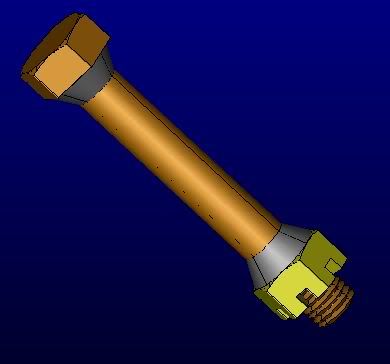

This is how I intend to fix my loose nose gear. The washers will be 60 degrees made from toolsteel and heat treated a little harder than the bolts. The taper in the nose gear mount can be done with a standard 60 degree countersink. The wear I discovered was only the bolt hole and the bolt where it rides in the mount. The middle portion of the bolt still fit snug in the gear leg. With this method I can retighten the bolt from time to time and have a positive tightening effect.
You can't retighten the taper pins with out re-reaming the hole because the pin will not move deeper into the hole.
This method is used in some cases of old aircraft restoration.
