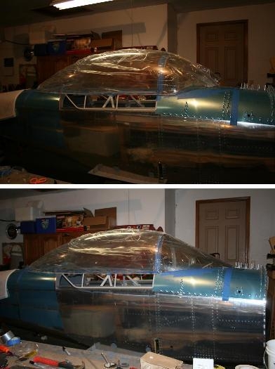

Default RV-8 flatwrap windscreen
Question for anyone who has used a flatwrap windscreen on their -8...did you need to cut down the rollbar to allow the windscreen and canopy to fit together better? I've looked at either raising the canopy or lowering the rollbar so that the steeply sloped windscreen would "flow" better into the curve of the canopy. I really like the look of Lyle Hefle's canopies, and I have the flat wrap from airplane plastics. ANY help, advice, photos, etc. would be GREATLY appreciated...thanks!!!

I'm a huge fan of Lyle's airplanes too. I love the flap w/s, much more like an F-15.
I'm using a longer than stock w/s and modifying my baggage door.
This picture shows the stock w/s vs the new one..
Click on the link on my address for details.

Wow, those look awesome. Were you able to just order just the windscreen or was it an entire canopy?

Chanler,
You just order a "flatwrap" windscreen from the folks at airplane plastics. They will know what you mean...I am still researching how to make it fit well, because the flat wrap and the canopy bubble have a disparity in relative height where they meet at the rollbar. It looks like I will either have to raise the canopy approx. 3/8" or chop the rollbar and lower it slightly as others have done. I am still trying to contact people that have done this successfully to see how they handled this issue.
