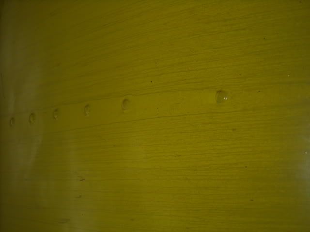

...for you guys wanting to reduce drag.
Years ago, I put drops of black, used oil on the leading edges of my homemade brake fairings on my Cassutt and I wondered if I'd shaped them correctly. I flew around the pattern and went wide open and then landed. Low and behold.....beautiful streaks all the way to the rear....good, laminar airflow.
So today while I was refueling my dirty Air Tractor for another load, I looked at the leading edges and saw the turbulence behind the round-head rivets and remembered reading in an EAA publication years ago that the first rivet causes as much drag as the next seven..well here it is...the leading edge is on the right side and the chemical streaks show airflow.
I'm gonna do the fuel drains and aileron hinges of my -6 with a few drops of black oil and go fly....a cheap wind tunnel.

That might just be the first rivet taking all the hit.

Pierre, excellent photo! That is how I found out that some of the cooling air exit area has reverse flow - I put drops of oil on the belly and noted some went forward!
I guess some of the air gets scared and climbs back into the cowl.

So the secret is out; what every glider-guider knows. The oil tells the whole story. If anyone can get there hands on some of the glider flight test reports from Soaring magizine, oil testing is a big part of performance maximizing. The biggest gain is to look at the transition from laminar to turbulent flow and reducing the drag from this transition. Most gliders have a step in the finish to trip this laminar flow to prevent a drag-inducing bubble, or reverse flow region. Besides keeping everything clean and dealing with the cowl exit, I believe tripping the flow results in the biggest reduction in drag. So if someone can minimize the drag from the cowl exit and trip the laminar flows properly, the airplane will have maximum performance. I suspect the only laminar flow is outside of the prop wash, but not sure. Good luck and hope to see a lot of oily planes out there.

I believe this is oil with food coloring added. Spots (dabs?) placed on the ground and flying then makes the streaks along the flow lines...

....if oil paints would stay wet long enough for a takeoff and flight to WOT.
I think we're leaving a bunch of speed on the table, as Dave Anders has already proven...a 265 MPH -4, even with 230HP he has really cleaned her up.
Bob Axsom(sp?) has already picked up around 20 MPH and there's more to be had.
I'm also gonna oil up the surfaces around the gaps between the ailerons and flaps and wingtips to see what's going on there as well.
