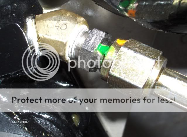

I used a brass ST 45. Ground it down for a more compact fit. Filled the male end with solder and drilled it. The local bearing shop had the fitting that I used to go from 1/8 pipe to 37o flair.
The orig. fitting leaked and I could not turn it to tighten it. I used a hack saw blade and cut it in half after I filled it with grease.
http://i362.photobucket.com/albums/o...1/HPIM1281.jpg

Default Success!
All done. That was a lot easier than I had expected. Man, I hope I don't have to remove that fitting any time soon.
Thanks for all the help.
Time to build on!!

The forward port will not give the same pressure reading as the standard one on the accessory case.
Louise's RV-6 had the sensor (for the gauge) screwed in to that forward port when she bought it, and it had apparently worked that way for many years. When we went to the glass cockpit and Dynon engine monitor, we changed it to a more normal configuration - that sensor up there is a lot of weight to get vibrated around. but like I said, the original lasted for a LOT of hours....
Originally Posted by N130WN View Post
So how do things differ for a "newer" engine? A straight fitting can be used? Doesn't look like Van's sells a straight one....
Newer engines have a port that goes straight aft right near the one that comes out the side and interferes with the engine mount. It's not hard to make your own straight restrictor fitting and come right off the back of an already-installed engine.
