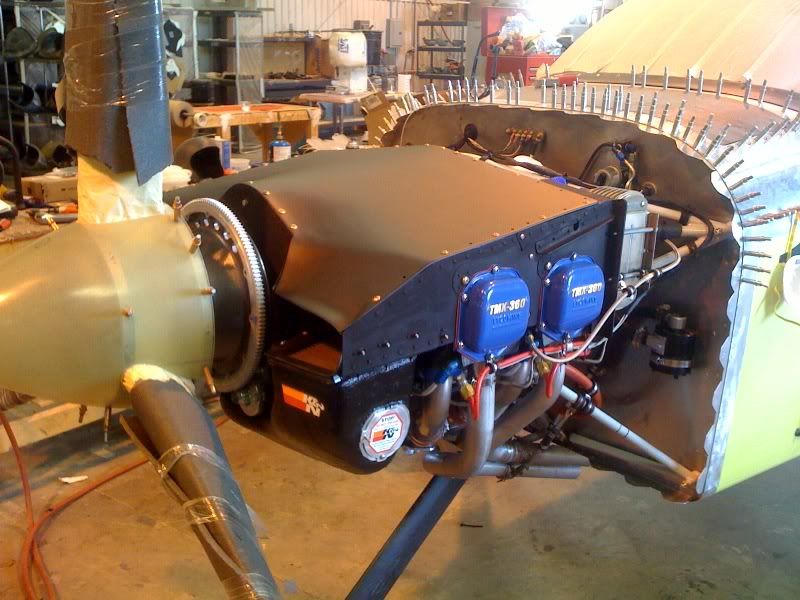

Default Here's mine
Just finished it yesterday. Overall really happy how it turned out. It could use some more block sanding but the matt finish really hides the lows. I may still sand when painting begins but then again I look forward to flying this year.

Very Nice!

Way too many fasteners. I'm going to do better next time.
