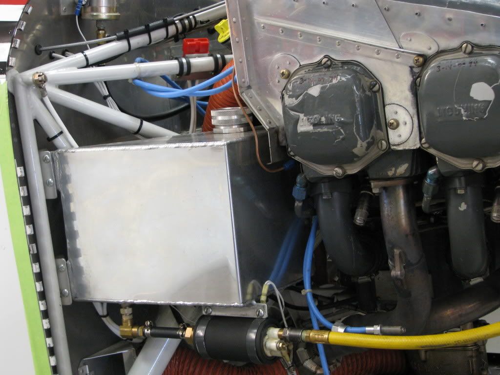

Default RV-6 Tank Location
A fellow builder made this tank for me. It holds a little over 2 gallons.
