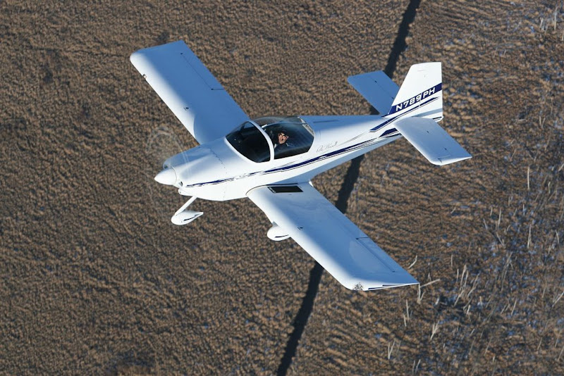

Can I put my N number on the vertical even if the last two letters go onto my Rudder? Wasn't sure If I could have any part of the numbers on a moving part. I read the AC on it and the EAA certification guide and I cant find anything saying I cant do this but thought I'd run it by the masses first.
  #15
Old 02-02-2009, 11:10 PM
petehowell's Avatar
Location: MN
Posts: 2,269
Default I did it....
No objections so far!
