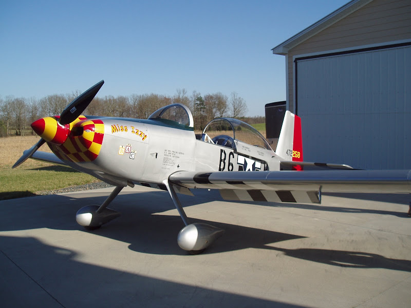

I have over 480 hours on my Whirlwind 200RV. It is smooth, fast and beautiful.
