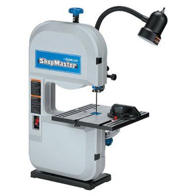

...a bench mounted Delta or Roybi two wheel band saw...
http://s7.sears.com/is/image/Sears/0...sm=0.9,0.5,0,0
...with no speed control will work fine for aluminum cutting using a wood blade of about 5 - 8 TPI. Since most cuts willl be essentially straight lines, a fairly wide blade will work.
No steel cutting though, unlike N941WR mentions.
