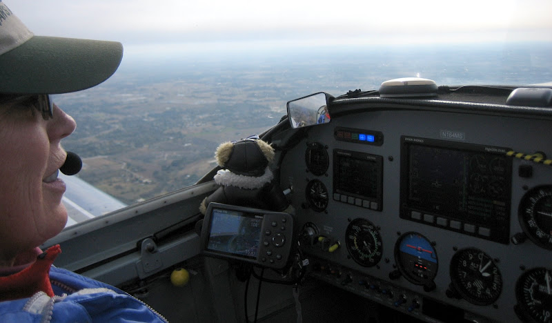

However, when we first departed Stephensville, my elevator trim wasn't functioning. This caused Louise to grumble and she made me hold back at 16 inches for the entire flight back 'cause she said the stick was too hard to hold forward at higher speeds. Fortunately, my new autopilot helped her out, but it wasn't strong enough to hold altitude by itself even at 16 inches. Paul called it travelling at Skyhawk speed. The Val had to fly off my wing on the way back, but she kept showing off....passing under and back. Boy, she can be annoying! They tell me that she will soon be my new step-sister and I understand that little sisters usually are annoying. So, I'll have to get used to it.
Back at Paul's hanger today, he and Dr. Hose took my floor panel out and discovered that pulling the connector off and re-seating it put my trim back in action. Paul then tie-wrapped the connector (or is that disconnector?) together and they buttoned me up. I guess there are always little, unintended issues caused by any significant procedure. Not too bad in the scheme of things.

Mikey, on the off chance that your servants didn't check this, tell them to look for a pin backing out of the "disconnector". The pins are often held in with a little spring tang at it's base. If it is not popped into place correctly, the pin can back right out of the connector body. I like to examine connectors I assemble with a magnifying glass to confirm proper seating of all the pins.
Best Luck.

The cheap little LED lamps that Paul put into the annuciator panel show up fine in bright sunlight, albeit I haven't had it at 10,000' over the Colorado Rockies on a clear day. But, they showed up fine on the test flights on clear Texas days and I really like having them.
