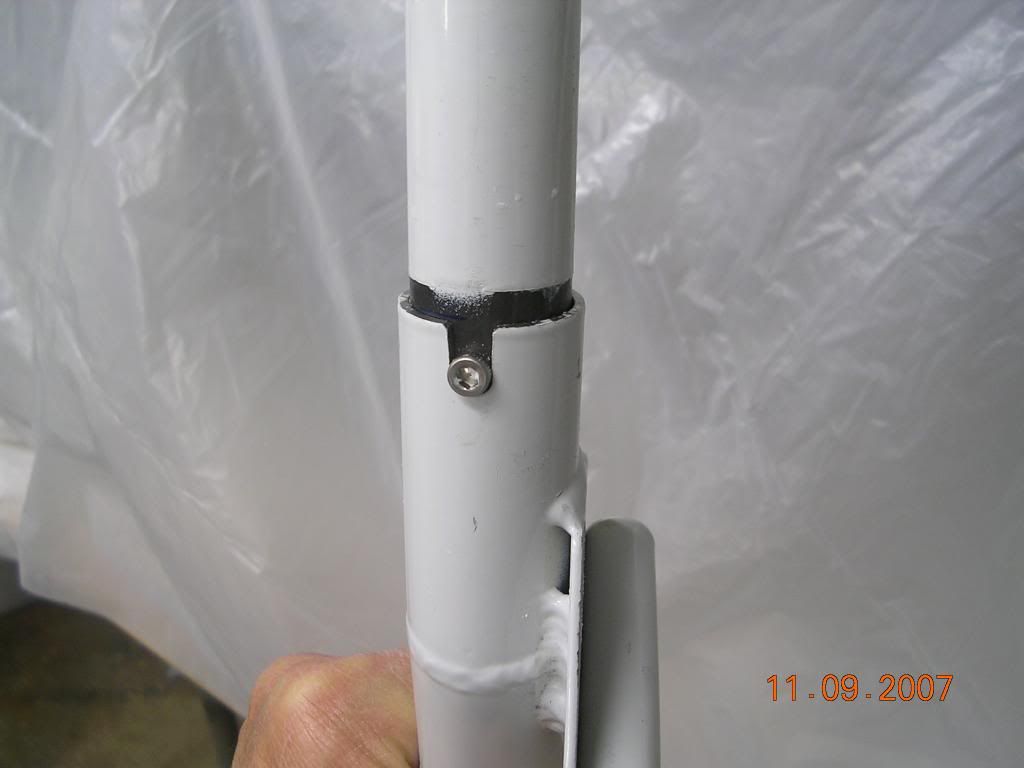

Here's my solution to the problem of having a "wired" stick that is REMOVABLE.
I thought about this WAY too long, but I'm excited about the results.
I just didn't see how there was going to be enough room for external wiring and connector.
I used DB9 connectors that are trimmed down to fit inside the tubes and used epoxy (West Systems) to "pot" them in.
You have to solder the two halves of each DB9 connector together, because when you trim them down you cut off the part that holds it together! The soldering is the easy part.
I had to install an allen screw (6-32) and make a slot in the reciever so the DB9's would line up when slid together.
I saw where "kevinh" had done this with a round headphone plug. But I needed 9 wires as I have a CH grip on both sides.
The photo's below show what I've done. I haven't cleaned them up yet. They will look better when I'm finished.
The powder coat line makes it look like it's not all the way in but it is!

Great idea Mark. May I suggest a safety idea?
How about using a camloc clamp ala mount bike seat post
clamp in order to prevent inadvertant control column disconnects? Unfortunately, although not common, it does happen.
Thanks for the great idea, & fly safely and long.

Great solution to a common problem. I recommend two things.
As mentioned before, Vans strongly recommends a bolt to prevent the stick from coming out inadvertantly. Maybe this can be accomplished by attaching an external boss or in internal guide tube so as not to pinch the internal wires.
2nd, You may want to find a tight fitting rubber cap to cover the lower tube when the stick is removed so foreign objects such as food doesn't fall in a get subsequently squished into the D-sub. that would be a shame. Good job!

Joel,
Thanks for the suggestion to clamp the stick in. I don't believe I have enough of slot cut into the receiver section for a clamp like you suggest to be effective. And I'd be reluctant to make the slot longer. But it could be done and would work I'm sure. I've considered a spring clip that would snap over the head of the allen screw when the stick is all the way down. That would be cool.
Bevan,
Yes, I had thought about a nice plug for the hole when the stick is out.
I can see my grandson dropping a milk dud down in there!
I wish you guys could see what a nice fit the stick is. I wonder if they are all that good from Van's. It takes a firm push to get it in and likewise a firm pull to get it out. And it's smooth, like it's polished.
And now with the epoxy plugging the tubes it has a suction holding it also.
When it comes apart it makes a sound like a boot being pulled out of some Mississippi gumbo. (sticky mud to you yankees). I could drill a small air hole but I think the suction is an advantage.
I've noticed even with the stick out the receiver section sticks up about an inch above the floor pans. I was thinking a metal cover should be made with a dome shape that would screw down over it, in case you wanted to haul some heavy freight (Camping supplies, beer, etc) and not be worried about it interfering with the controls.
Has anyone done this?

How would you service those connectors?
Hi Kahuna,
Servicing? When I build something it stays built
Seriously though, you would have to get a big drill bit and go after them!
Chew them all up until you can get them out to replace them. it would take a few hours to replace them for sure.
Or you could just buy another stick and socket/weldment and start over.
I would think the MTBF would be very high, unless the aforementioned milk dud accident happens.
It's just the co-pilots stick after all.
Mark
