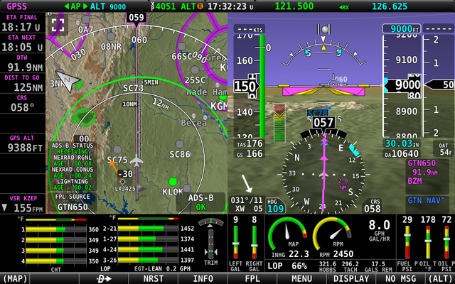

Shoot fire - I have no experience with 6, 6A, 7 or 7A - but I can read Van’s numbers and these speeds appear short of the mark. As discussed, first step is to figure out CAS to IAS doing the GPS runs. As a side note, if using just a Van’s analog airspeed instrument for IAS they can be 7+ knots off in reading (personal experience). I built an simple manometer to check, and then used the same manometer to calibrate two of these instruments over the speed range of 50 to 200 knots.
A 180hp, CS two place RV should be over 160kts in cruise. I have done many data runs in my RV-8 to tweak out the last percentage or two of fuel economy in cruise (IO-360-M1B, Hartzell BA CS prop). Below is a screen shot from my trip home on Saturday.
So back to the OP:
- Wheel pants and gear leg fairings on? Can easiely add 10+ knots
- Rigging out of wack? Can easily cost +5 knots
- Engine running right (timing and such)?
- IAS accurate?
- Other builder’s experience with this prop? Prop selection is not trivial and it goes beyond just FP or CS.
