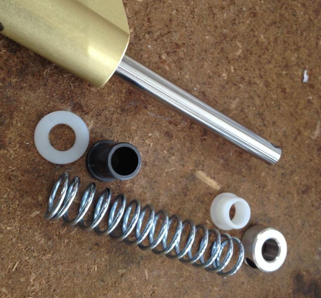

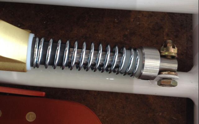

As I hate to say it but the master cylinders go bad and cause your brakes to drag. I’ve personally replaced them with Grove masters In 6 Rvs and 2 Glastar’s. Rebuilding does no good. Only thing I’ve seen that helps completely release the brakes is installing a external spring on the shaft.

One add on. To prevent the peddle’s brake cylinders from failing to fully extend after pressure is applied, you can slide Springs over the cylinder rods. They need to be Long enough where the springs have enough load to push the cylinder out. This will help prevent drag issues caused by the cylinders not fully extending.

I’d be interested in a picture of how springs are installed
Thread post about it here https://vansairforce.com/community/s...0&postcount=24
