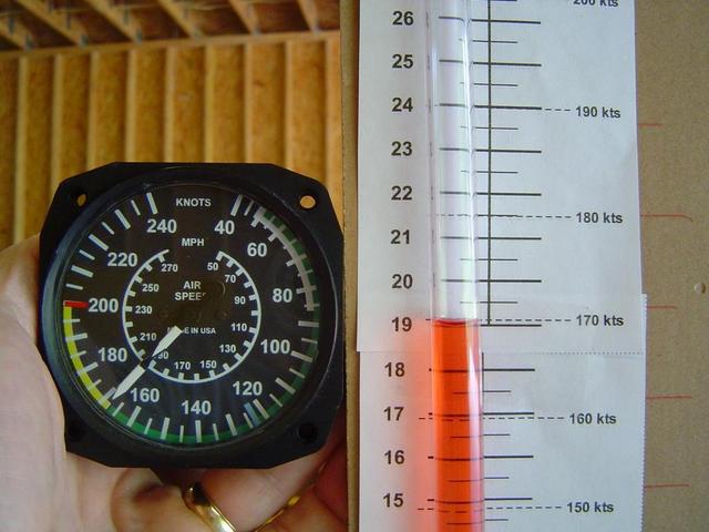

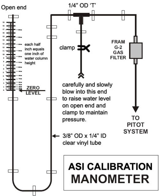

Build a simple manometer and verify your ASI is correct. It might be simple but it is very accurate. PM me your email and I’ll provide the PDF file for the scale to convert inches to knots.
If the ASI in correct, then placement and/or shape of the static port is the leading suspect.
Note - for the manometer a big syringe or blood pressure bulb work well for the pressure source. Add a few drops of food color to the water to make it look pretty.
Carl
