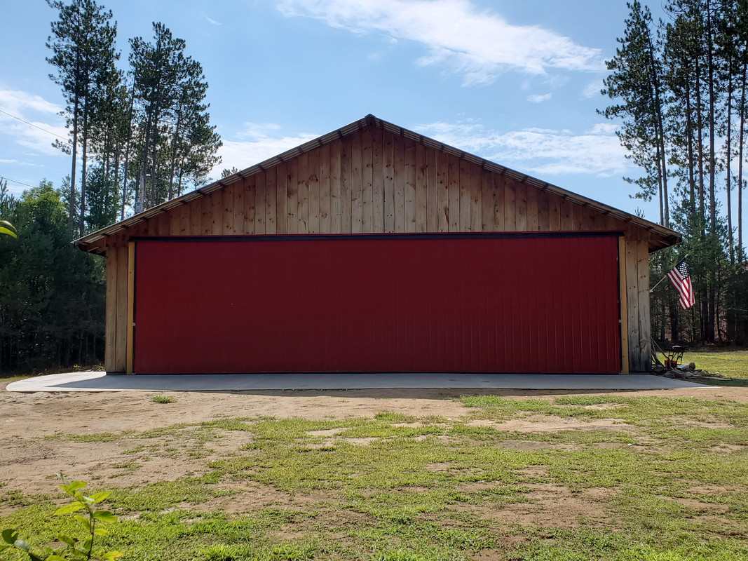

Just finished installing a 44'X12' HiFold door to my 50'X50' hangar. Installation was surprisingly easy using a fork lift to hold the door in place while you bolt the hinges to the header. Cables and locking mechanism already pre- adjusted, plugged it in an works like a charm. Very sturdy and well made steel frame. Door opens to 11'5"" only losing 7" of clearance. A very good value.
https://i.postimg.cc/YqHcC480/20200824-111450.jpg
Door $6800
Sheeting & Insulation $1000
Shipping $800
Jake
RV6 #20477 completed 1991 sold.
RV7 #72018 N767T first flight 11/21/2017 350+ hrs.
IO-360M1B MT 3 blade, Dual AFS 5600 QUICK Panel.
Manual Flaps. (KOXC)Oxford, CT, (0NY0)North Creek, NY.
1941 J3 Cub skis,floats.
2020 dues gladly paid.

I have two Hi-Fold doors and like them very much. They are a good value and easy to install. My 16 year old daughter and I installed one with my loader tractor.
On the other hand, my friend has an hydraulic door and likes it very much. I am impressed with it. If I were buiding again and wanted to spend the money I'd go hydraulic. I'd put in a pioneer coupler so I could raise it with my tractor hydraulics if the power went out.
Whichever door you use, keep in mind to add in the weight of insulation, sheeting, etc., to the door load. It's easy to get the door over weight.
