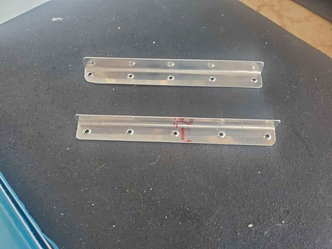

Here are some pics of the modification, and yes Mel, the pop rivet dimpler IS the way to go.
https://i.postimg.cc/63DM6tdd/20200827-140150.jpg
https://i.postimg.cc/VvWXy84s/20200827-145803.jpg

Are those ordered from Van's or did you make your own?

I ordered a set from Van's, then decided to make my own. The top 4 rivets can be bucked, and with a specialty bucking bar you could probably get the bottom one. I chose a MK319BS blind rivet for the lower fastener.
