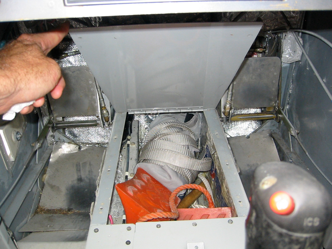

Hi....I know in the day and age of instrumentation and our small panels every square inch counts ....but has anyone done some sort of storage area above the battery between your legs ? I will have at least a portion of that area available and would really appreciate others experience. Pictures would be greatly appreciated. I know VANS has the " glove box that drops down ....might be applicable for me but I have never seen one Many thanks in advance. Stew. stewhansen@shaw.ca

Short answer, yes.
When I built my Four back in the late 80's. innovation still started with "I." Before the Eight was even a thought, the RV4 needed a forward baggage container.
I came up with mine on a long leg staring between my legs at the battery box. I relocated the battery to the firewall which helped my CG and hinged the forward edge of the box. Voila, lots of room for a tool box, canopy cover, small chocks, whatever...
Additionally I fitted the top of the cover with small fittings that when closed allowed for a bungee cord and attached my small backpack there on top.
Here's a pic...
Hey I flew Bronco's too...hope that helps...
