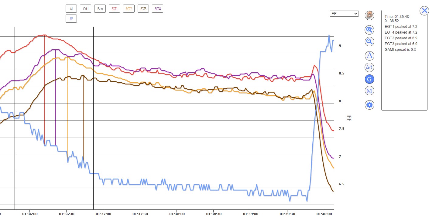

Shouldn't have to guess at the spread, the Savvy site will tell you this exactly.
I'm tuning my new AFP system right now. Here's a chart from a test run this past weekend. Click the "G" in a circle icon at the upper right to enter GAMI mode. Then click the cursor at a point before the first cylinder peaks, and again after they've all peaked. Savvy will immediately show you the peak for each cylinder and the spread.
I also agree with what others have said, the lean sweeps need to be done as slow as you can stand to do them for best results. This is not the best example since it was only a little over 30 seconds from first peak to last peak.
This 0.3 spread was not bad with all restrictors at 0.0240, but I think I can do better. I have a 0.0235 & a 0.0245 arriving today from AFP.
Note that I'm also still re-calibrating my FF sensor after the change from carb to injection, so these FF readings should be taken with a grain of salt.
