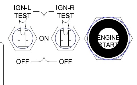

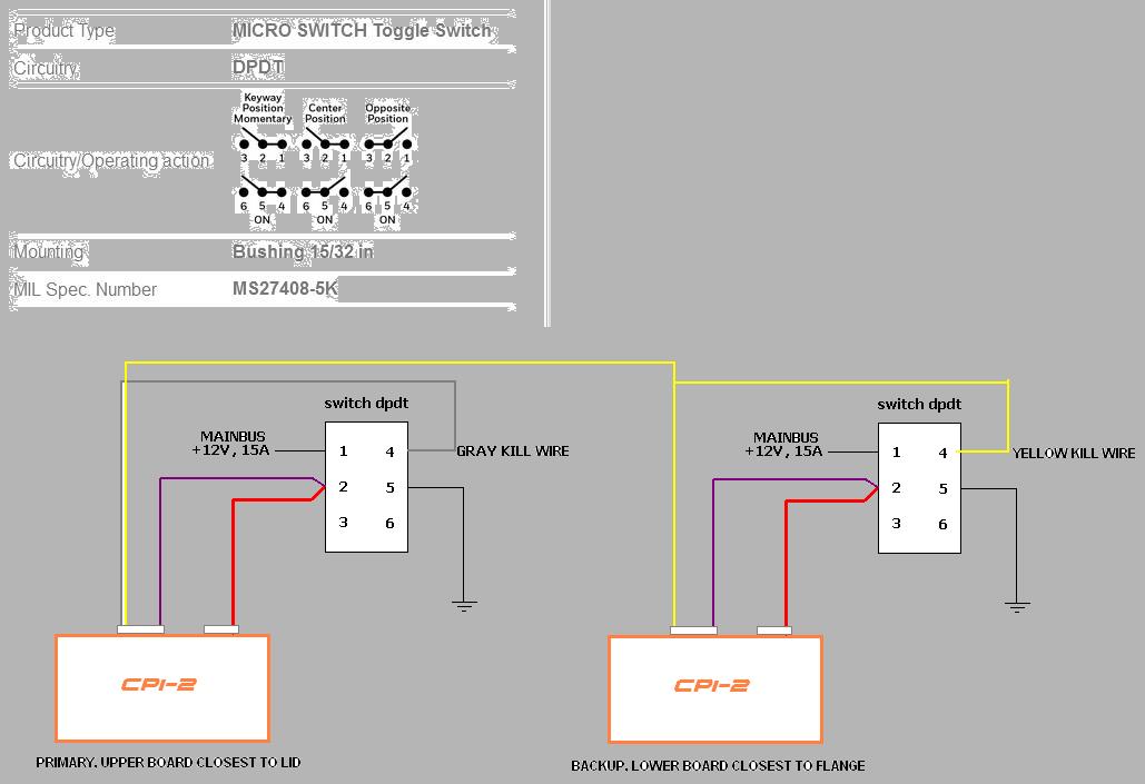

I've been running a dual CPI-2 setup for just over a year. Great unit. Like an earlier poster, I've only needed access once to install a capacitor into each of two wiring connectors.
I'm finalizing a new panel design with SteinAir, and based on feedback from SDS, I will be using a pair of locking toggle switches to provide "off", "run", and "mag check" positions for each ECU.
That portion of the panel design looks like this:
This is a wiring diagram that I got from SDS. I understand that this was created by another SDS customer, and reviewed by SDS.
I'm very tight for panel space, so this makes the most of a limited amount of real estate.
David

It appears you have both CPUs and Coilpacks wired directly to the main bus through the switch. SDS recommends individual breakers or fuses for each CPU and each Coilpack.
You may want to double check this with Ross or Barry.
From the installation manual:
"The Purple 20 ga on the 14pin main harness plug, needs a 2 to 5 amp fuse or breaker."
"The Red 18 ga wire on the 12pin coil harness plug. Needs a 10 to 15 amp fuse or breaker."
