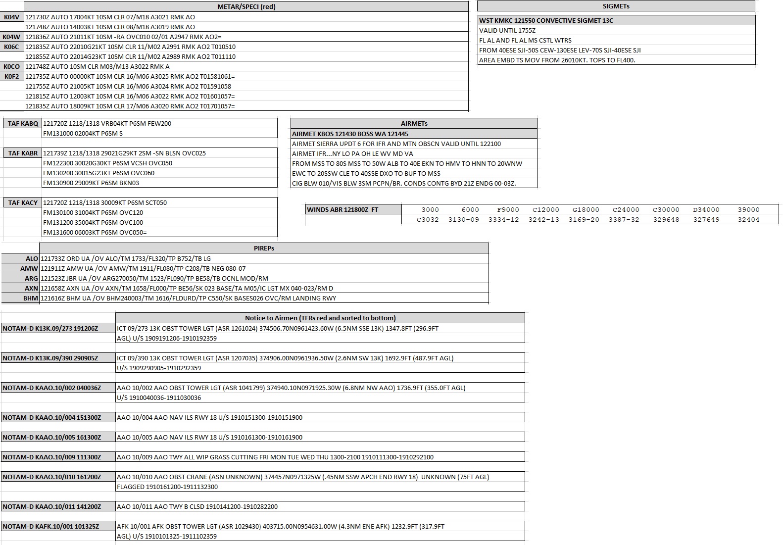

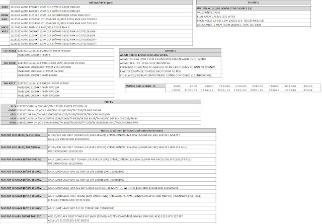

  • FIS-B text products are extracted and provided in a new sheet. You can see METARs, TFRs, PIREPs, Winds Aloft, TAFs, CWAs, etc. from your entire flight.

Example of FIS-B data (shown here formatted differently than in the program).
