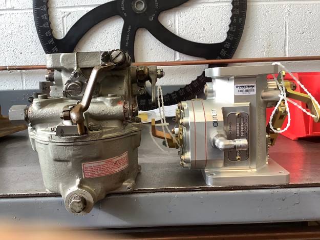

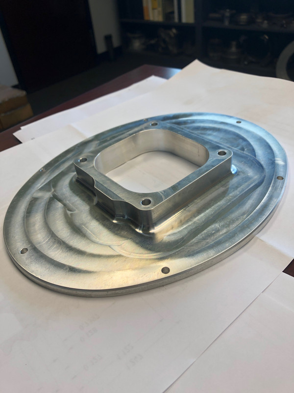

Old 07-14-2020, 09:44 AM
Northernliving Northernliving is offline
Join Date: May 2005
Location: Boston, MA
Posts: 449
Default Spacer and other parts
Originally Posted by HansR View Post
Hi.
Modifications
What needs to be done to the engine?
Obviously I do not have any holes for injectors.
Thankful for help / HR
Hans, I'm also in the process of replacing an O-360-A4A with a clone injected engine. Assuming you are keeping your sump and vertical intake, one of the challenges you will face is the height difference between the carb and the injection servo. Since you will want to keep your airbox and intake in the same location, you may have to make a spacer. I decided to fabricate a part that included the top of the airbox cover and the spacer. See attached photo of the carb vs injection servo and the new part I'm fabricating to orient the intake in the same position to match the cowl.
Other parts of you will need would be a new high-pressure fuel pump and possibly a new pressure sensor speced to accommodate the higher pressure.
I'll post some more pictures as this progresses.
