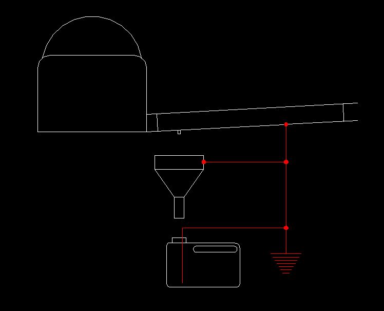

I need to remove the right tank to repair the vent line. What is the best way to remove the fuel. It is full. The left tank is approximately 2/3 full.

I just drained the tank on my 7-A by removing the fitting for the sump and drained it into 5 gallon cans.

A length of bare wire clipped to a metal part of the RV with the other end dropped into the bottom of the plastic should reduce the possibility of static spark discharge.

When I was calibrating my tank floats, I got some hardware store pipe nipples the same thread size as the tank drain, a quarter turn valve and a length of rubber hose to allow be to de-fuel into 5 gallon containers. There was still a splash of fuel when removing the drain and installing the pipe/valve/hose assembly. Be wary of static discharge.

Listen to Sam. Airplanes and hangars have burned.
Electrically tie the airframe, funnel, and fuel in the jug, then ground them. Can't spark if they are all at the same potential.
I use a metal funnel with the appropriate wires and alligator clips permanently attached.

What ground is best? Hangar frame I-beam steel?
There isn't a ground rod nearby in my hangar.

I think that's fine. The ground is a plus. The important thing is to ensure the same potential for the airframe, fuel/jug, and funnel. The fuel is picking up a static charge as it falls through the air. If it builds enough, it will discharge. Tie all the components together and it can't build.
