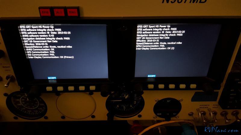

I had the same problem a few years ago. Display looked like this:

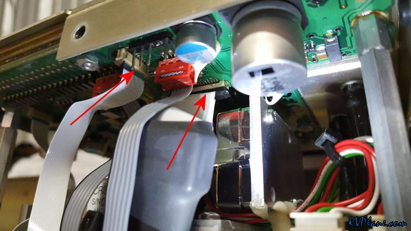

I cracked open the box and re-seated the ribbon cables.
Came right back to life!

I too have had a ribbon cable issue. 2009 vintage, not the newer Sport with the thin case. Only downtime in 10 years.

I had an alternator failure and even with load shedding, I had one GRT look just like that when the voltage dropped below about 9 volts. The other GRT was on a back up battery and lasted 35 to 45 minutes. I have rewired the power feed systems and added a back up alternator. Just saying low voltage will look like this. Call GRT!
