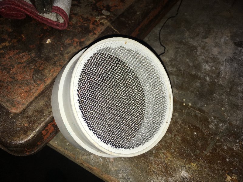

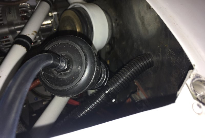

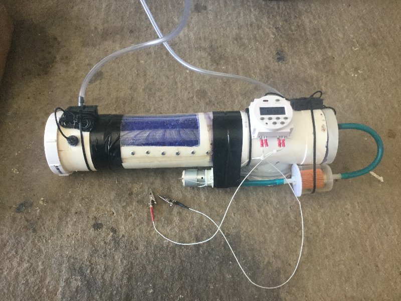

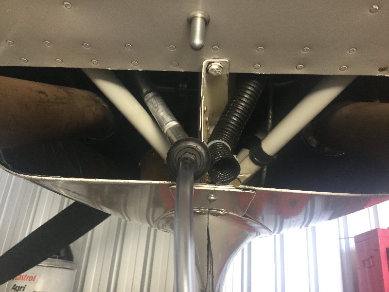

Here is my closed loop dehumidifier made from 90 mm storm water pipe and fittings.
There is an empty chamber at each end and a middle chamber which holds 1 kg of beads. The beads are held in place at each end by metal screens (water tank outlet mosquito screen fitting) which should help promote even air flow through the beads.
The homemade window allows me to see when the beads change colour - clear acrylic 90 mm tube may have been an easier alternative?? Most of the fittings are glued except at the left end where it is pushed together and sealed by the black tape so the beads can be removed to dry. The 90 mm Tee piece at the other end stops it rolling around. The humidity meter probes and air in and out tubes go into the empty end chambers. The blue tube is air out after being sucked through the beads.
Rubber chair leg ends (idea from a local RV10 owner) from Bunnings (Australia) connect to the oil filler tube and breather outlet. The black rubber is reasonably soft and flexible and fits snugly - 38 mm for the oil filler and 16 mm for the breather. Note I have the antisplat oil separator but the outlet is at the cowl air outlet so is easily accessible.
I don’t have mains power in the hangar so use a 12 volt deep cycle battery. The two humidity meters with probes, aquarium pump, timer, solar panel and charge controller are all inexpensive items from eBay. The little motor pumps plenty of air but only seems to work sucking rather than blowing through the beads. The timer turns on daily at 4:30 am when the engine is cold (higher internal relative humidity) and runs for 30 minutes. The first 30 minute run brings the RH down to about 26%.
I take out the dipstick and connect this to the breather outlet for a few minutes to purge the hot moist air before connecting the dehumidifier.
