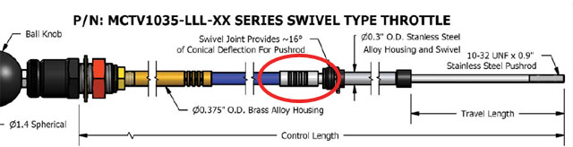

Does anyone have a source/part number for appropriate clamping hardware to use on the end of a push-pull cable that is not equipped with a threaded section?
Specifically, I'm considering swapping out my throttle control with the McFarlane vernier-assist. However, their assembly doesn't have the threads at the end to secure it in a hole, as my current one does.

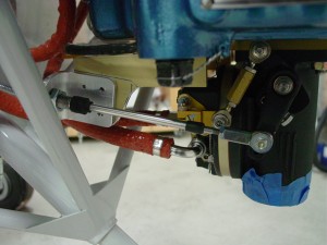

Thanks, Walt. I just need to find that part in a large enough diameter; the spec on the cable indicates that the sleeve that needs to be clamped is .375" OD, and those clamps are only listed for 3/16 and 1/4 diameters.
Originally Posted by N427EF View Post
I am not sure why you would want to switch from a "normal" throttle cable to a McFarlane without a threaded end?
I would think twice before installing something other than a standard throttle cable.
To be clear, the cable I'm looking at does have the threads on the end of the push-pull part to attach a rod-end bearing. (See image above from the spec sheet). The threaded part that's missing is the bulkhead thread to secure it to the fixed bracket aft of the throttle arm...at left in below photo (picture is of my existing install with an ACS cable). I'd agree that a bare-wire end should be avoided on the throttle; I used threaded cables on my purge valve, too.
