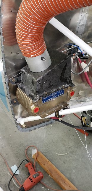

If you can, do firewall mounted. Here is my setup on the RV-8. Standard 3? hose to the Airflow 2006X. The butterfly valve is normally shut some to keep the oil temp up (so far this spring at least).
This is the second build using this cooler - I recommend it.
Carl
I only count 10 rows, the airflow 2006x is listed as a 13 row cooler. I'm considering the same question as OP and am debating between the 10 and 13 row cooler.
Sorry, his is the 2004X cooler - I used the 2006X cooler on the RV-10 with a 4? SCAT hose. The RV-8 uses a 3? hose. The cooler on the RV-10 worked so well I decided to stick with the Airflow brand.
But - recommend using a butterfly valve to control cooling air. Every day is not 90+ degrees OAT.
Bob - I don?t like firewall mounted batteries for a variety of reasons. Is there just no other option?
I do know an RV-14A can have two firewall mounted PC-680 batteries as well as a firewall mounted oil cooler. Perhaps you can as well.
