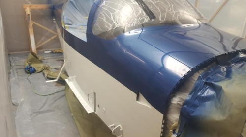

I painted in a homemade paint booth, but still had a mosquito land in the fresh paint on my elevator. I decided there was no way I was getting him out without making things worse. I just painted over that little bas&^#d. You can still see him....
