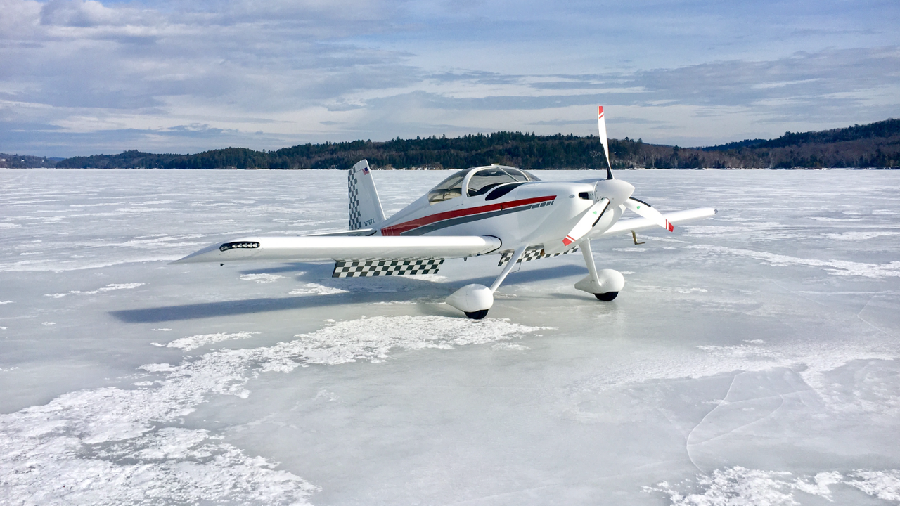

Let's not rule out snow and ice.
https://i.postimg.cc/TYFTCfy7/a1wc-CMu-1.png
Jake
