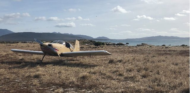

To the OP, about 95% of my flying is done from dirt, gravel or grass airfields in my RV-7. There are potentially a few mods to look at that may help a little. If you want to keep the wheel pants on and see yourself flying into these types of airfields often, you should look at installing the following tire that will fit on your standard rim, used the same tube, be be 1" wider and 1" larger in diameter. If the existing wheel pants were filled according to Van's spec, they should still have 1/2" clearance at the top, and just need to be trimmed around the bottom a little to fit the tire (I trim to 1/2" clearance and that seems to work fine).
http://www.vansairforce.com/communit...ad.php?t=23360
I'd also recommend some 3M paint protection film on the leading edge of the horizontal stabilizer, and perhaps some under flap, where I seem to have a ding or two.
Whilst grass, dirt and gravel are fine, it's the undulations or roughness that's more of a problem. The RV's gear legs can take a bounce or two, but they have little damping. I flew off a well mown strip but undulating strip and ended up causing a crack in the wheel pant around the rear mounting screws. This was fixed by reinforcing the area with an aluminum plate and soft, flush AN426A3 rivets, but annoying all the same.
In all, a totally capable backcountry aircraft on prepared strips assuming you do your part.
Good luck.
