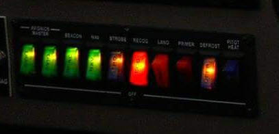

GalinHdz's Avatar
GalinHdz GalinHdz is offline
Join Date: Mar 2010
Location: KSGJ / TJBQ
Posts: 2,034
FWIW here is what I have.
Switch Panel Color code:
GREEN: Normally ON while operating the aircraft
BLUE: ON or OFF while airborne
YELLOW: Lights
RED: "Special" Situation(s)
Light Switches:
BEACON(G): Always ON (in case I forget to turn the master switch OFF before getting out of the airplane)
NAV(G): ON as soon as the alternator comes on line.
STROBE(B): ON prior to taking the runway and while airborne until clear of runway. The STROBE switch only has power if the NAV switch is ON so the NAV lights have to be on for the STROBES to work.
RECOG(Y): Also known as "Wig-Wag" mode, ON before I start to taxi.
LAND(Y): ON when cleared for takeoff then OFF once safely airborne. ON when cleared for landing then OFF once off the runway. LAND/TAXI mode overrides the RECOGNITION circuit so I don't accidentally get a flashing effect while landing or taxiing at night.
Galin
CP-ASEL-AMEL-IR
FCC Radiotelephone (PG) with Radar Endorsement
2020 Donation made
www.PuertoRicoFlyer.com
