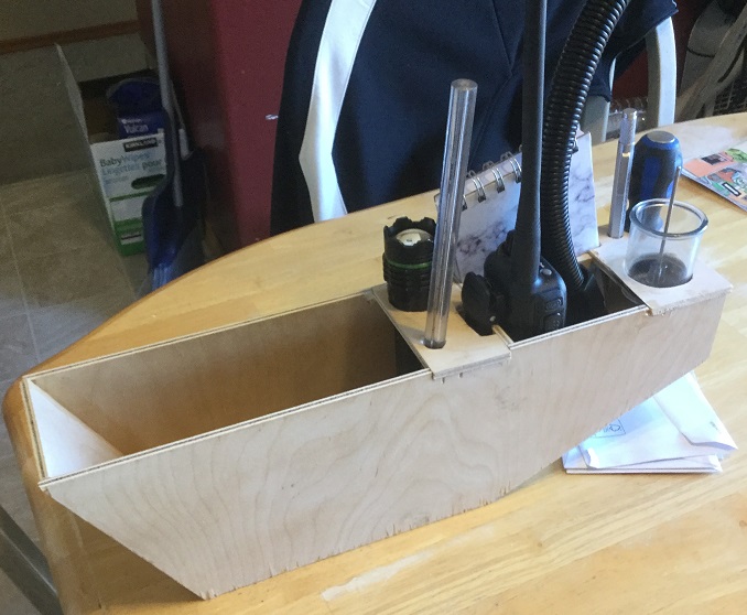

Default Here's mine
Just finished my center console. 1/4 birch plywood from aviation aisle at Home Depot. Includes arm for iPad mount and custom cutouts for
  • Handheld radio
  • Flashlight
  • Notepad and pen
  • Fuel dipstick
  • Fuel test cup
  • Screwdriver (fuel cap opener)
Also has a large (3-1/4" W x 8" L x 5" D) opening for whatever else I might need.
Here's a couple of pictures. I'm pretty happy with how it turned out. Downside of using plywood is a few cosmetic chips, but most of those won't be visible once this is installed.
