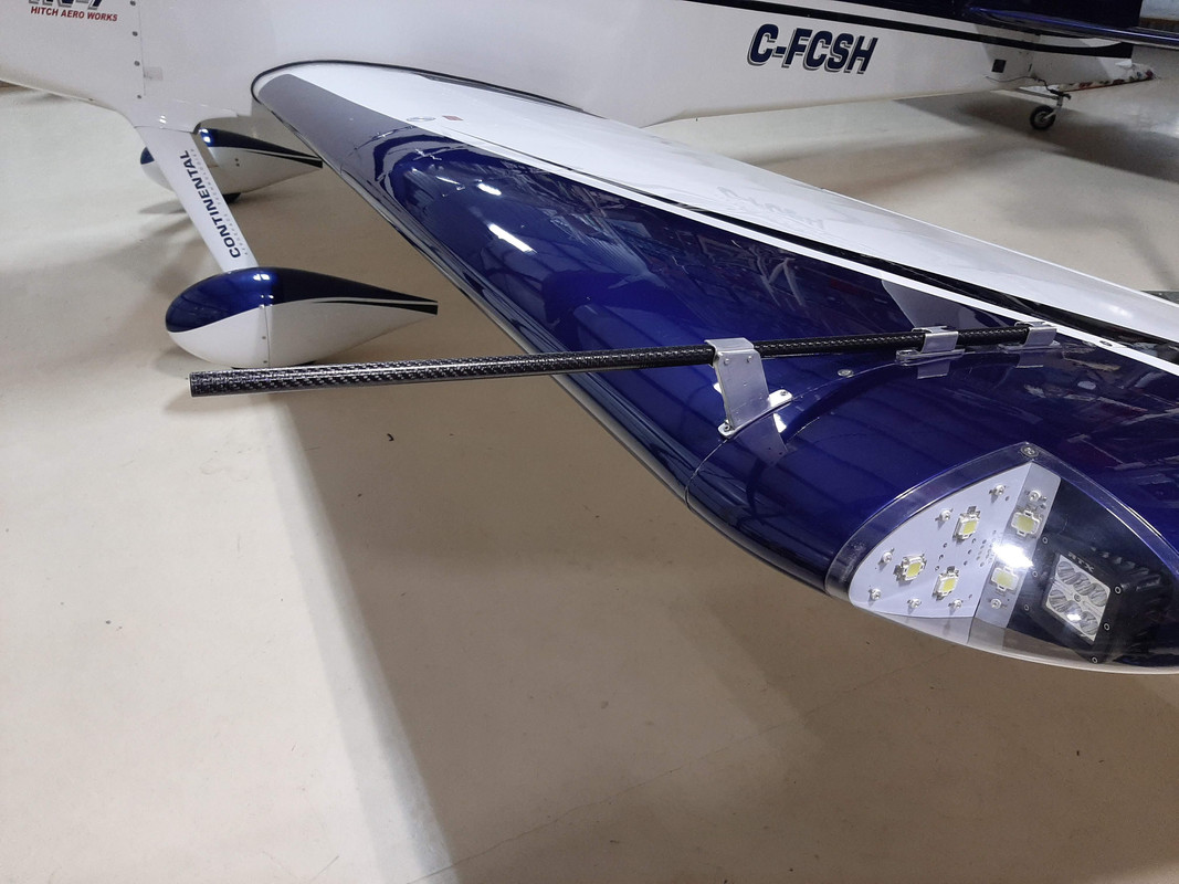

I Wanted a better perspective for inflight photos so I made this mount to extend ahead of the wing by 2 feet. Makes a real difference.
I used 3/4” carbon fibre tubing with 3/4” aluminium square stock (all provided by my hangar mate John). I fabricated the brackets to fit into existing holes/nut plates for the wing tip attach points.
I was worried about vibration but it turned out great.
First photo is of the mount without the camera on the end. Second is a photo with the go pro mounted on top of the wing (old position). The third photo is with the camera mounted on the new carbon fibre extension rod. Much better photo.

I have been thinking of doing something similar. What is the wall thickness of the 3/4? carbon tubing?

I?d say probably 1/8th inch wall thickness

I love it!! I've been wanting to do the same from the VS, mounting my 360 Fly to get shots "above" the aircraft. I'm not a machinist, nor do I have access to create the exquisite mounting hardware you have. Kudos! Can you or your hangar mate duplicate the mounting hardware?

HI David, yes it can be duplicated but I made the pieces to match the holes I had already drilled to attach the wing tip. Not even the same as my other wing...

Would these mounts be something that would lend itself to 3D printing?
