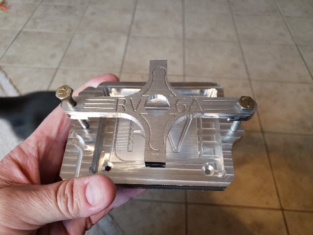

On a fun side note, i already made the battery holder, that was a fun project as well.
