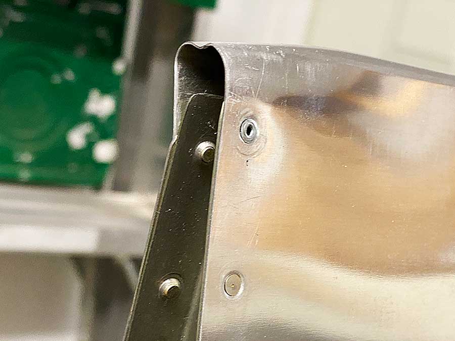

Back on March 14th I put up a post about dropping my wing in the shop
The aileron has been fixed and I kicked the can down the road on the lower wing skins and end rib.
Talking to Van's tech support, they said re-skinning the flap is doable but take a crack at fixing it first as I have nothing to loose.
I thought I would canvas the best minds in the RV game to see how you would approach this repair.
Here's three photos of the damage.

I think the best success will come if you drill the skin off. That way you have full access to both inside and out. If you don't succeed, just buy a new skin and replace it.
If I have to drill the skin off, I'll fit a new skin. I'm contemplating drilling out some of the top skin to bottom skin rivets for access, then resemble with MK-319-BS pull rivets.
I'm reassembling my old flap stand to make it easier to hold the flap steady when I attempt to knock the dent out.

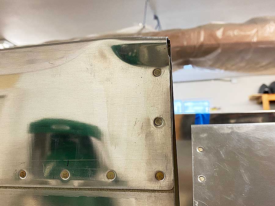

Michael, your second picture shows that the damage can be worked out fairly easy if you drilled out the rivet on the end rib and removed it. Then use some wedge shaped dollies/bucking bars and a flat faced hammer to bring back to its original shape. Then just re-rivet the end rib back in place. Follow it up with a small amount of filler if necessary for a smooth appearance.

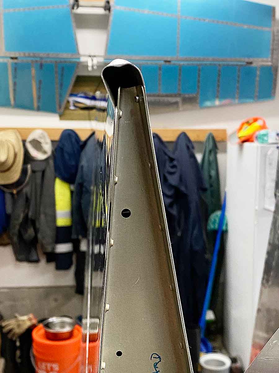

I agree that end rib needs to come out. The impact dented the trailing edge and then pushed the skin askew. The skin loaded on that first rivet and the force creased and buckled the skin. Getting the crease out will be the bigger challenge. You have to relieve the stress at that rivet and get room to back it with a bucking bar of some sort. My only concern about the trailing edge is the potential for cracking. 2024 T3 gives you one or two shots before fatigue. Go slow and don?t over work.
As you look at the repair attempt, think about the sequence of events as the flap hit the floor. Try to repair in the same sequence in reverse. Work the crease and buckled top skin and flatten that part of the skin, then progress to the trailing edge. The skin should then start to lay flat as the trailing edge comes into shape.
Have fun. You have nothing to lose. Working metal is both science and black art. Experience is the only teacher.
