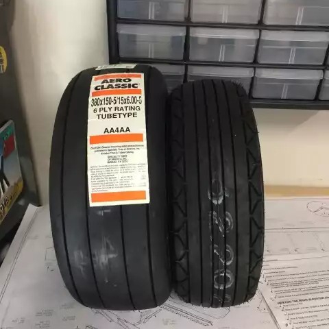

Here's a pic of size comparison.
https://i.postimg.cc/8zjBJCkf/20180906-225322.jpg

  #18
Old 03-23-2020, 08:34 PM
Pilot135pd's Avatar
Pilot135pd Pilot135pd is offline
Join Date: Jan 2019
Location: Vaca Moo Airport - TA37 in East TEXAS
Posts: 1,332
That's a great picture, thank you.
