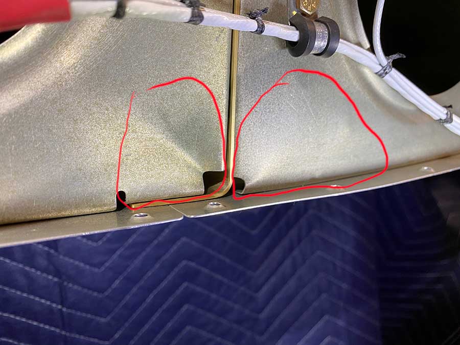

Originally Posted by cderk View Post
Michael -
Don?t worry about it. You can fix it no problem. Just take it slow and be patient. At the end, it will not look perfect, but hopefully your painter can take care of that. I did something similar. Here is my screwup. This is a lot worse than yours... this is my fuel tank - wing slipped while moving the plane to the airport.
My issue is that it compromised the tank and leaked like crazy. I was able to fix this in about 3 hours.
This is encouraging...Thanks

Originally Posted by Marc Bourget View Post
That looks workable with a rubber mallet and a "custom" bucking-backing bar for the trailing edge. Use a "fresh" rubber mallet. One that's sat on the bench in the sunlight for awhile will act like a metal hammer as far as the aluminum is concerned.
The toughest task is the "fold line" along the rib in Pictures #5&6.
Not sure what to say about what appears to be a depression in the skin (Picture #2) just forward of the trailing edge - would need more pictures.
In pictures 3 & 4, return the "dip" to normal profile first. Leave it in and it will work against your further efforts. Use a "custom ground" bucking bar ground to the radius.
In picture #4, once the dip is restored, I'd start with an offset bucking bar on the shop head of the rivet and attempt a "push" with the heel of your hand to get a feel. Or judicious use of the rubber mallet. Keep the force low, almost like your trying NOT to move the metal. Make haste slowly and you may stay in front of creating more complications for yourself. Fixing this will take less time, overall, than it will take to rebuild the part.
finally, is the black line on the trailing edge of the rib, just that or a crack?
Go patiently and you'll have better luck.
If you have more questions PM me with your phone #
FWIW
Thanks for the tips. The black line on the trailing edge rib is just streaked primer.

I suggest giving Vans a call. Trying to straighten skin is difficult and time consuming. It is often quicker to replace a skin than try to straighten one that is bent.
Van dinged a wing skin on his latest build and replaced it rather than trying to straightened it. That plane is now flying.
The factory tries hard to keep replacement part costs reasonable. We have all been there. I have lots of scrap in my hanger, a good reminder to take my time on each step.

I feel your pain as i had my stabilizer, elevator ready for paint.
the whole unit slipped off the table i was working on and hit the only sharp object on the floor, consequently a rip appeared in the elevator. I will replace that with a new skin.
As for your bends there, i have had great luck in straightening those out with a body dolly(auto) and small hammer. You must be careful though as too much hammer and you will stretch the aluminum. If you look for detents and hammer each side of the they will encourage out.

Well I walked into the shop today and the light was just right to see some more damage on the wingtip.
It looks like when the wing fell off the sawhorse the wing hit the cement floor right on the spar.
I spoke with Van's about this today and they said to work the deformed rib out and if needed put some gussets on the rib.
