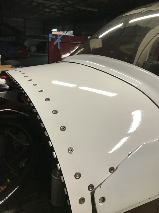

The white on the -7 as well as the striping is vinyl. One sheet for the top of the wing and one on the bottom. One sheet on each side of the fuselage fuselage split down the middle. The only seam there is aft of the slider track. Striping is accomplished using 3M knifeless tape.
And all that was accomplished in one day per post #8?

Update: I just reinstalled the avionics bay cover and looks really good. Now I want to wrap the top cowling. I think it can be done with a single piece of vinyl. I haven?t done anything with compound curves so I?ll wait for warm weather when material is more pliable. I have seen YouTube videos where hot air gun or open-flame Bernzomatic torch is used to facilitate stretching. Probably take until warm weather just to work up my nerve?
Jim-
Your top cowl will be very easy to do with one piece. Start off working from the middle out, not much heat will be necessary on that shape. Stay away from torches, no need for them. My heat gun is only turned up half way and I only use it on real tight surfaces. Cold stretching the film is your friend.

Yes we covered the -7 in one ( long) day, one of us had experience with applying vinyl wrap. The flat flight controls literally take only minutes apiece. The wings are 2 big sheets, definitely a 2 man job. The fuselage took the most time, however the beauty of the 3M vinyl is if you screw up laying it down, you just pull it up and reapply. A Good heat gun and some sharp razor blades as well as felt covered plastic squeegee will do the trick. The striping is a lot of fun using the knifeless tape, you can experiment with the design till you are happy. Slap on the colored vinyl, peel the wire and you have a very nice fine line stripe. Maybe some day I will peel the vinyl off and white base coat the fuselage, but I am very pleased with the vinyl up to this point. Regardless however, I will always be using vinyl for the striping.
