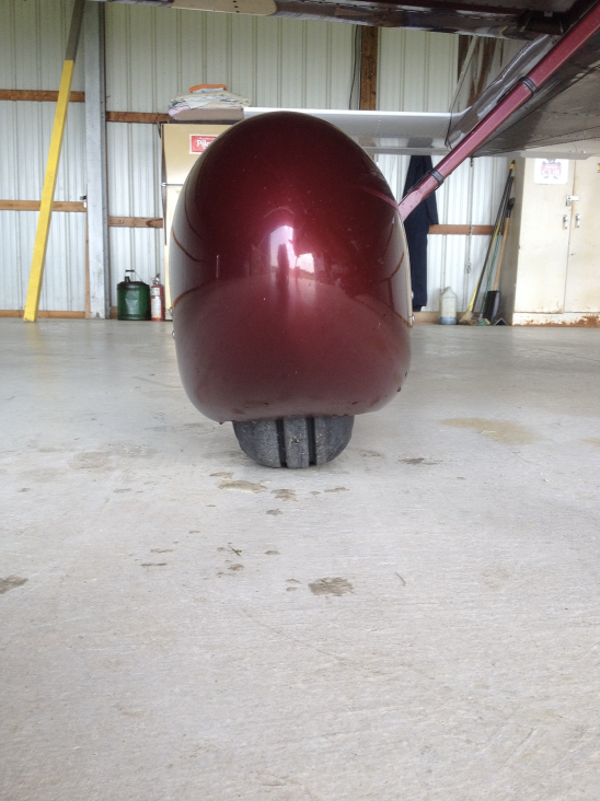

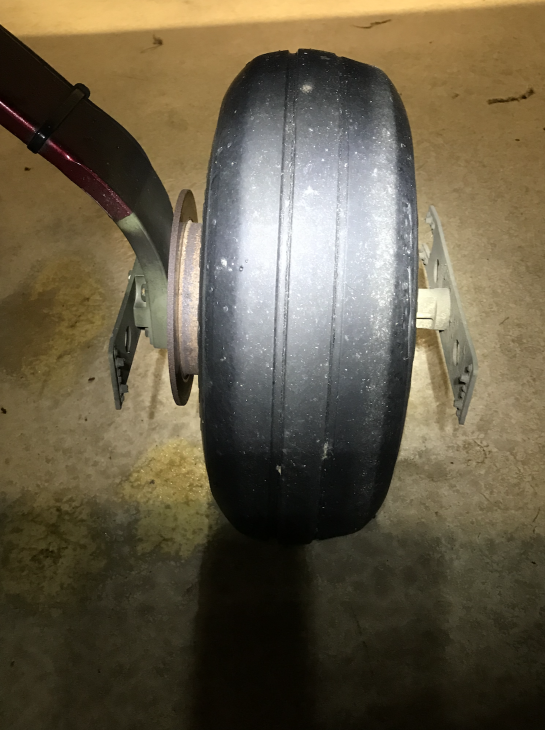

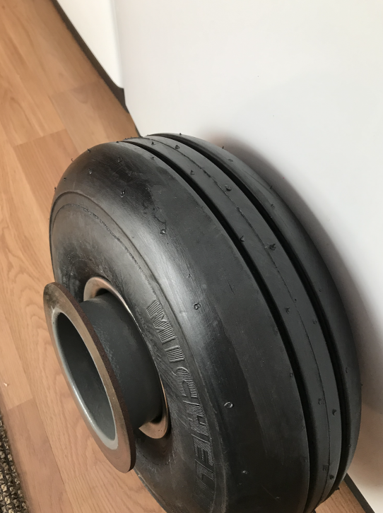

I run Desser 500-5 6 PLY AWBS RETREAD ELITE PREMIUM 2 GROOVE (ELITE) on mains for RV-12. These tires have a thick tread on the outside edges to counter the excessive wear from large camber angle on the un-sprung gear. Tires are ~$80. Desser ran a Thanksgiving sale three years ago and included a LeakStop tube free with each tire purchased. Been looking for that sale ever since...
These tires are a little bigger than original tires so check for 1/2" clearance to wheel fairing.
New
300 Hours
New again 3/20
