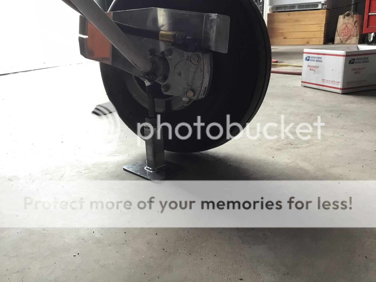

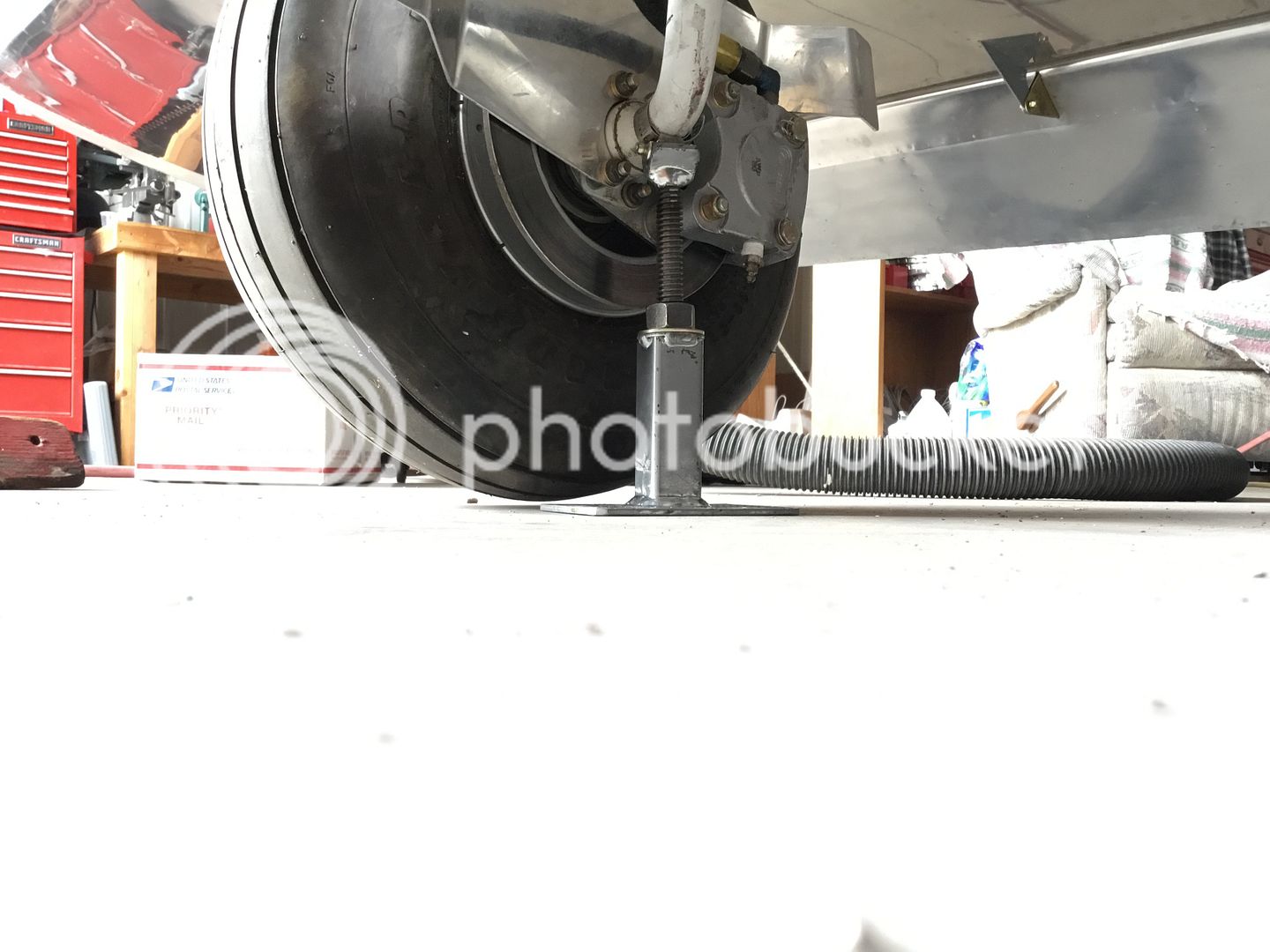

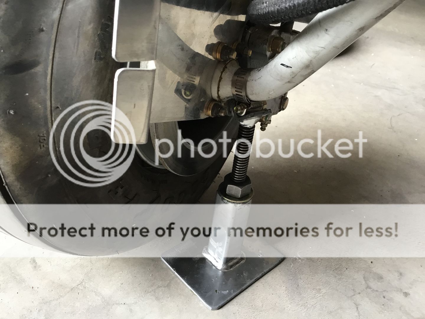

Default Photos From JB
JB volunteered to test one of these. He used the jack for brake maintenance.
He sent some photos, asked if ok to share them. He replied that it was.
Here are some photos of the jack at work.

I have a beta version too. Tried to lift my friend RV9 but didn?t remove the wheel. It gets the job done. I used a hose clamp as an anchoring point.
  #28
