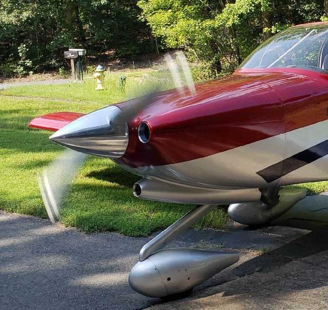

Originally Posted by majuro15 View Post
I?m interested in the plenum for the RV-10 and suggest designing it to fit the ShowPlanes cowl. I was told years ago the 10 James cowl molds were destroyed.
Correct. My understanding is that Will James got so much noise on the RV-10 cowl that he just stopped making it. A lot of this noise was from a handful of builders with ?strong opinions? on VAF.
Too bad. The James Cowl on the RV-10 I built has performed beautifully for the mission I built the plane to do, high efficiency cruise. In fact, if I ever build an RV-10 again a go/no go decision will be dependent on the availability of a new James Cowl. I don?t see Van?s updating the stock cowl anytime soon.
Carl

Default nice cowl!
Originally Posted by Carl Froehlich View Post
All I can say is "wow!" That's a really nice looking cowl!
Mickey Coggins
http://rv8.ch
"Hello, world!"
Indeed it is, in particular matched with that spinner.
No - never said that. It can fly at 90 knots all day long. I just don?t like doing that. Perhaps I phrased what I said wrong.
I launched out of Phoenix at 110 degrees then a climb up to 14,000?, no issues.
Carl
I hear ya' brother. Those inlets are what, about 4.5"D? Although the results are acceptable to you, the data says the few builders with the 6" inlet cowls probably do better.
It's an interesting case of styling vs performance. The smaller inlet ring and sharp edged exterior profile won't perform as well as the larger inlet and a rounded exterior profile, but the pointy look is fabulous.
Given the opportunity to revise a design for the -10, I'd be looking at a 6" low Vi/Vo inlet with Cessna/Mooney style baffling and no plenum. See the TTX, the Acclaim, or our own Mark Frederick's latest Rocket cowl. None are ugly or slow, and they all cool very well.
