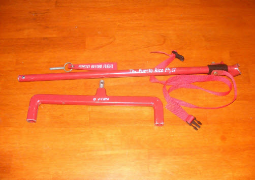

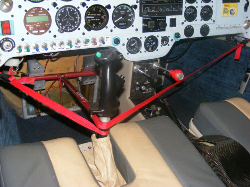

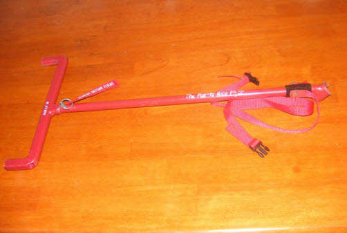

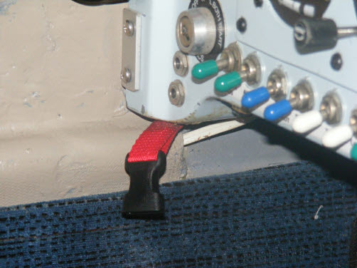

Originally Posted by Pilot135pd View Post
If Pierre is still active here, any chance you could repost the pictures on another server, maybe Imgur.com so more RV'ers can benefit from this design?
You can also make one out of some aluminum like I did many years ago. I know of one person that used reinforced schedule 80 PVC.
They follow the design used in the Diamond DA-40 gust lock system and works well. The best part is that it is impossible to take off with the gust lock system installed. You can't even get in the airplane.
Galin
CP-ASEL-AMEL-IR
FCC Radiotelephone (PG) with Radar Endorsement
2020 Donation made
www.PuertoRicoFlyer.com
Gracias. I built one like that but the problem for me in the RV-8 was you can't remove that type without getting in the plane (or hanging headfirst on your stomach over the side ) so once you removed it now you had to climb out to store it away then climb back in. I'm not 20 years old anymore and the hardest part of flying my plane is getting in it !
