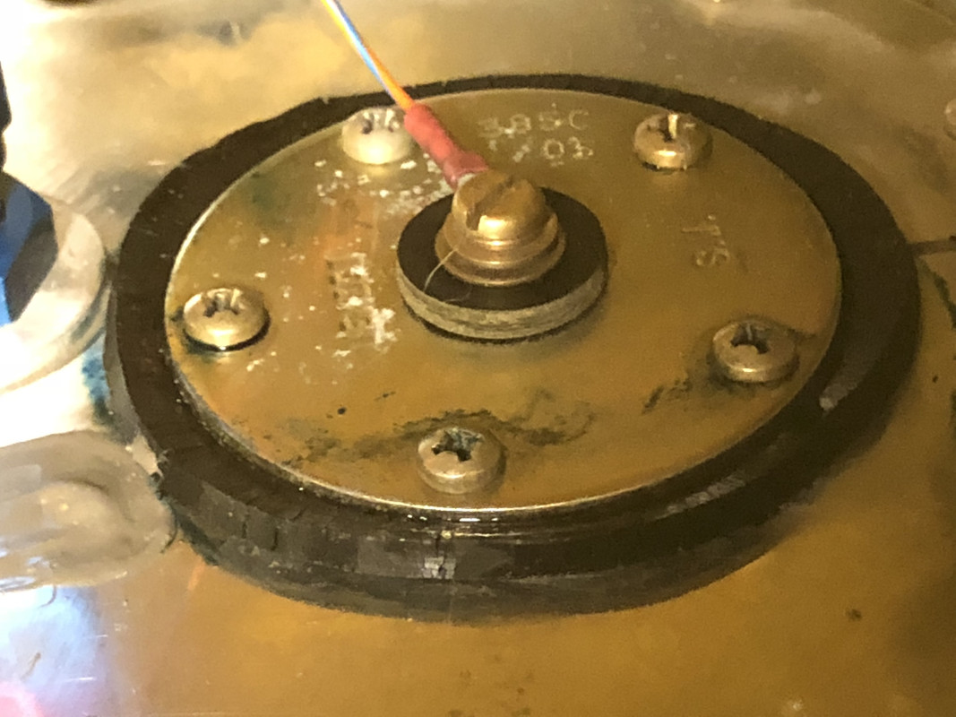

Anyone have suggestions as to where or how I can efficiently fix or replace the black rubber gasket where my fuel metering is coming from? I wonder how long these gaskets are expected to last. I have pictures I took this morning, but I don't know how to attach it.

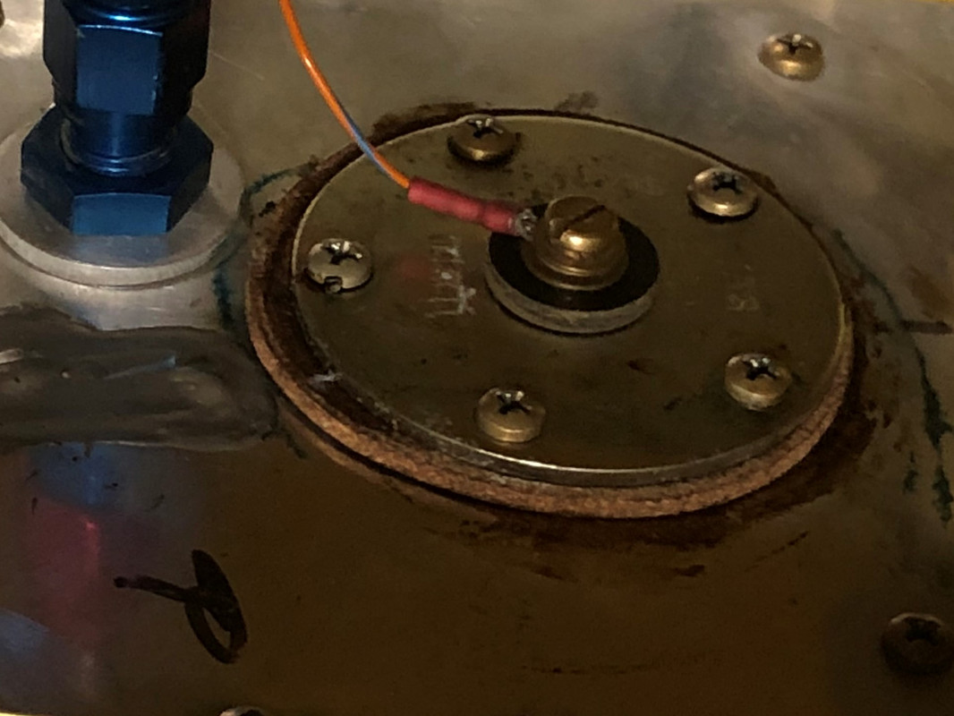

I purchased a 2015 RV8 in 2017, and had to replace the rubber gaskets in April of 2018. I replaced them with cork and some Permatex 80019 Aviation Form-A-Gasket. I've used Permatex 80019 for nearly 40 years on lots of motorcycles(an old Greeves that was a chronic leaker) and cars and it's never let me down. Great stuff. I pumped the tanks out, removed the wing root fairing, removed the sender, cleaned all the pro-seal off the area (being very careful not to get any in the tank) and put it all back together with the cork gasket and a thin film of 80019. Took and evening to do both tanks. Not a drop leaking since.
I'm pretty sure the instructions tell you to throw away the rubber gaskets. Not sure why the builder of my plane used them. If I can find a picture or two, I'll post them.
I used a pump similar to this one.
https://www.amazon.com/Sierra-Tools-...782122&sr=8-11
Edit: Adding photos

Over time the cork will eventually become saturated with fuel and leak again.
The permanent solution is to remove all gaskets, clean thoroughly and reinstall using only pro-seal.

The next time it leaks, ditch the gaskets (rubber or cork) and just seal things with proseal. It will still removable, and will have a much lower probability of springing a leak.

Maximum longevity I've seen for the cork gaskets is around 5-7 years.
