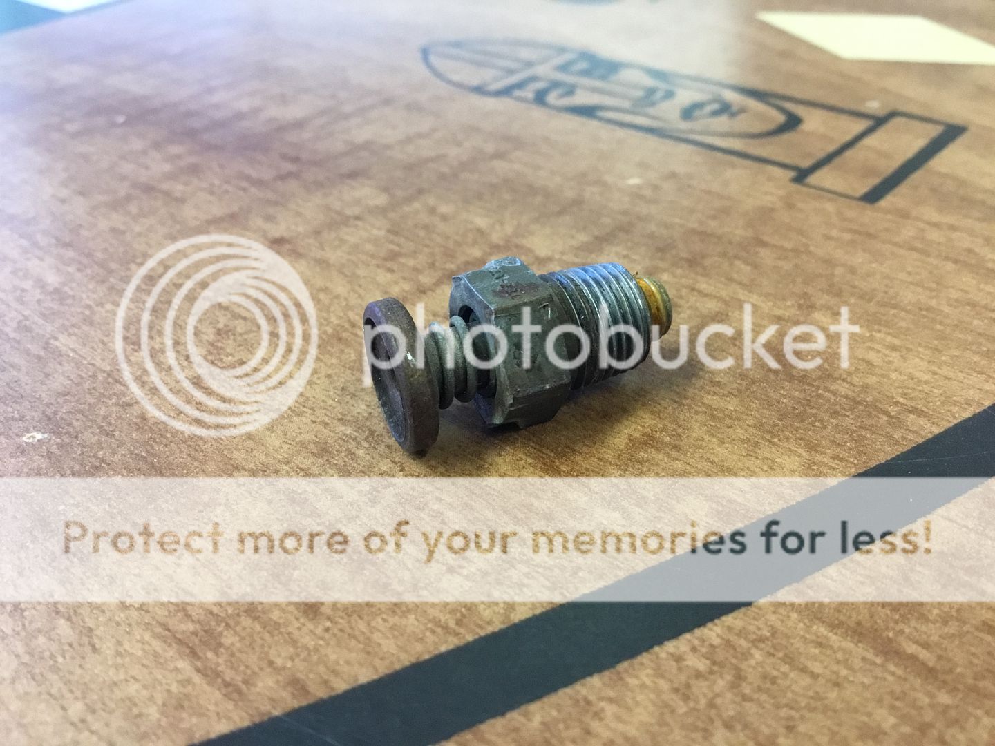

Right wing valve dripping. Maybe O-ring needs to be replaced. Local mechanic also recommend I keep a spare handy. Spruce has differs models. I do not know the model number. Is there a known standard Push Type Drain Valve for the RV-7A?

Yes, Van's sells it. Buy one and a couple of spare O-rings to fit it.

Per RV7 plan sheet 16A which calls out drain valve CAV-110. The o-ring part # MS29513-006 as noted at the bottom of your link.

You need to get a set of plans/manuals for your RV-7A. They are available for $10 on a flash drive from Vans:

SAF-AIR now makes a stainless version of the CAV-110 but ACS doesn't yet show they carry it, even though I asked well over a year ago.

I recommend the SS version from Vans

The manufacturer of the fuel drains is SAF-AIR (www.saf-air.com)
Either the CAV-110 or CAV-110SS will fit the Van's 1/8" NPT bung.

Is there some advantage to SS over the brass ones which they previously supplied with the kits (and which is what I have)?
Or do they just look cooler?

The non-stainless steel ones are gold cadmium plated steel, so they can rust after a while.

If you fly a lot and sample a lot they may even freeze on you between condition inspection. A locking pliers are needed to hold the tank flange to prevent flange rivets damage during drain removal.
