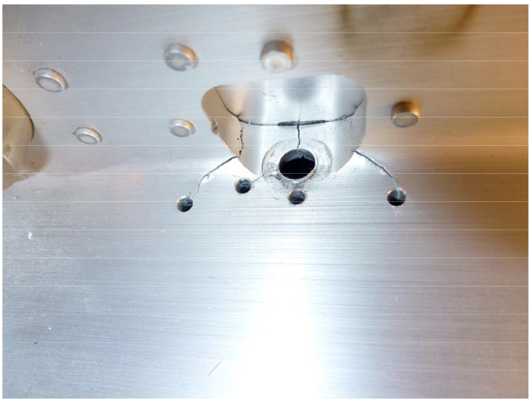

SB 12-11-09 - Center Section Modification
I bought my RV-12 early SN (120058) from the original builder with 48TT knowing that SB for Center Section and Fuel Tank were not completed. I flew for a year before completing these two service bulletins. I guess I was having too much fun and the RV smile wasn?t wearing off. So, in my case the Center Section Modification was completed at 205TT. No cracks were found during the work. This area is given extra care for visual inspection during Annual Condition Inspection. No cracks at current 521TT.
The reason for resurrecting this thread is to see how this fix is holding up to the test of time. I fly off of a private grass strip that is not very smooth. The runway has not been rolled for the past two years and frost heave in the winter has worked its magic. I would imagine my landing gear has been subjected to near maximum abuse short of training flights and really poor landings.
Has anyone noticed new cracks forming or propagation of existing cracks that were stop-drilled during the SB?
As a reminder, the attached photo is included in SB 12-11-09.
